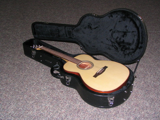

here is build #4. hope the pictures work.
it's a slightly swollen OM (i'm calling it a Grand OM) - a shade wider in the lower bout, tighter in the waist, and deeper.
the bracing is 1/4 inch, X braced like a typical martin copy.
the scale is 25.4.
engleman top.
padouk and e.i. rosewood back and sides (sides are lined with maple veneer for extra strength with almost no extra weight)
5 piece neck (maple, pad, mahogany, pad, maple). the padouk was left over from the back pieces.
madagascar rosewood binding with padouk, cocobolo and white purflings.
the mosaic rosette is from lmii and is meant to be a bit of a nod to larivee (the godfather of canadian steel string building) and as such, also a nod to what's become an incredible community of canadian steel string builders.
bone nut and saddle.
e.i.r. bridge, fretboard, and pins.
ktm9 - rubbed out by hand (my arm almost fell off!)
gotoh tuners.

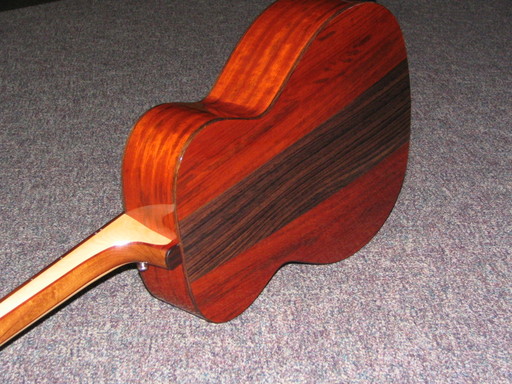

looking at it now, i think the back looks a little blingy, but the guy that's getting it will know he's got a one of a kind, and more than anything, he's going to love that the sound is even, bright, and HUGE!! (if i do say so myself).

could you talk more about your finish, it's application by hand etc please?

Very sweet guitar! Like Serge said, tell us more about the finish.

about the ktm, for someone like me without a lot of cash for spray equipment, or a dust free room for finishing, or any interest in nasty fumes, this water based stuff is the way to go. it's not quite as tough as laquer. but the benefits far outweigh the sacrifice.
that said, my first few attempts at a water based finish were average at best. the biggest problem i had was getting good flow out. on the first three guitars i was left with all kinds of ridges to sand out. i was nervous about trying it again until i found out from a full time builder in vancouver that you could mix ktm as much as 50/50 with denatured alcohol.
that's what i applied as a light first coat. (all coats were done with a foam brush). after that i mixed in silica powder to thicken it up a bit, and applied what must have been 6 - 8 coats of that. the top only got this mixture for 2 or 3 coats. seems like a long drawn out pore filling process, but i'm happy to avoid the mess and smell of epoxy. also, if i sand through at any point, it's really no worry because i'm just dealing with one product all the way down to the wood. touch up is easy at any point. even just before the polishing stage you can wipe on a little 50/50 with a j-cloth and be able to blend it really well with 1200 wet paper - but i'm getting ahead of myself.
after the pores were filled i followed with another 6 - 8 coats, decreasing the amount of denatured alcohol as much as i could while maintaining decent flow out. i then waited about 2 weeks, then leveled with 400 wet and continued sanding all the way up to 6000 micromesh.
after that i used two polishing compounds. the first came with my micromesh kit and i assume it's the equivilant of a medium. i finished with mcguire's show car glaze.
i think the finished product looks great, but a buffer is pretty high on my priority list. i figure that i could probably save at least 3 hours/guitar!
i taped off the headstock and used ktm on it as well. the rest of the neck is finished with lee valley gel finish which is an absolute breeze to use and leaves the neck feeling silky smooth. all it takes is 2 days to get on 6 or 8 coats. same stuff on the bridge. i believe that's the same product as behlen's master gel, but dont' quote me on it. i got the idea for this stuff from dingwall basses in saskatoon. they actually take a little wax to the neck yet, but i figure it might get so smooth you couldn't hold down a bar chord.
hope this has been helpful.
